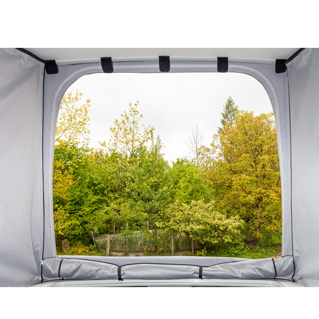

There are big windows with zipper on three of the sides. If there is a front opening in the gaiter, ISO-TOP can also be opened completely.

ISO-TOP MK VI remains mounted inside the pop-up-top:
the top can be closed with the ISO-TOP installed inside!
ATTENTION: When closing the pop-up roof, the front opening of the ISO-TOP has to be open!
The front opening can be rolled down and attached with straps to two buttons.
Lower fixation with hook-and-loop fastener all around: Cold air cannot penetrate into the berth.
The new attachment above has a precise attachment and the best possible seal.
At the front ISO-TOP is attached with hook-and-loop fastener to five special holding-pads, which have to be permanently fixed to the front interstice of the roof lining.
Fixation at the side with hook-and-loop fastener.
