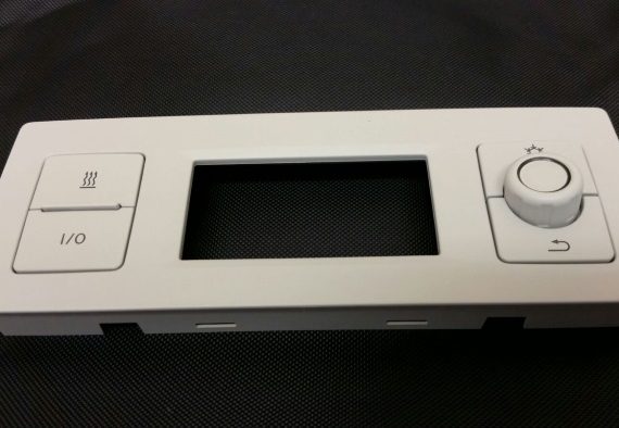

Genuine Volkswagen replacement knob for the VW California SE and Ocean central control panel, also included is a replacement fascia.

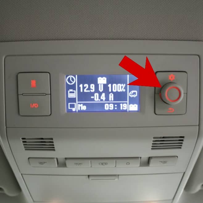

Due to a design fault many control panel knobs are failing where it will not engage on a menu selection, this replacement knob will cure this problem.
Instructions available as download.
Made in Germany
